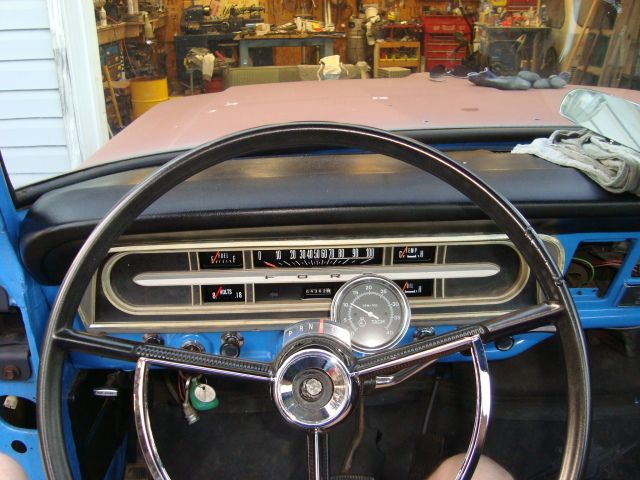

Somewhere along the project I forgot to post up a pic of the finished volt meter, here it is. I used a label print program at work to make the scale.
It's one of those little projects that make the whole driving experience so much better.

Lone Ranger
Blue Oval Fan
Blue Oval Fan
Posts: 583
Joined: Tue Jun 21, 2016 2:27 pm
Location: Northern Michigan
Re: The chronicles of Lou, '70 F350 dually Cummins project
Postby Lone Ranger » Sun Jan 08, 2017 3:34 pm
That voltmeter is sweet! Looks original too!

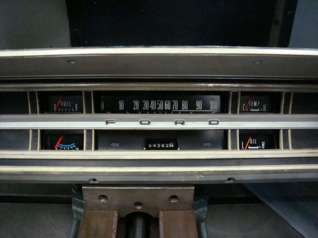

I had a whole thread on the volt meter install but lost it so here's the abridged version.
Found one of these at Carlisle for a couple bucks.
Comparison to the stock ammeter.
Popped the bezel off with a small screwdriver to take the gauge apart. Ammeter behind it for comparison.
Yep, gonna work but the gauge face doesn't look right or fit
Back side shows that I'll need to open up the mounting holes and use the fiber washers for electrical isolation.
Used a file to fit the stock back plate to the Sunpro gauge
Fiber washers installed. I think I opened the holes with a unibit.
Some decals I made up at work while trying to get a decent font match.
Done.
For the wiring I just rewired the main cluster connector for +vdc and ground.
