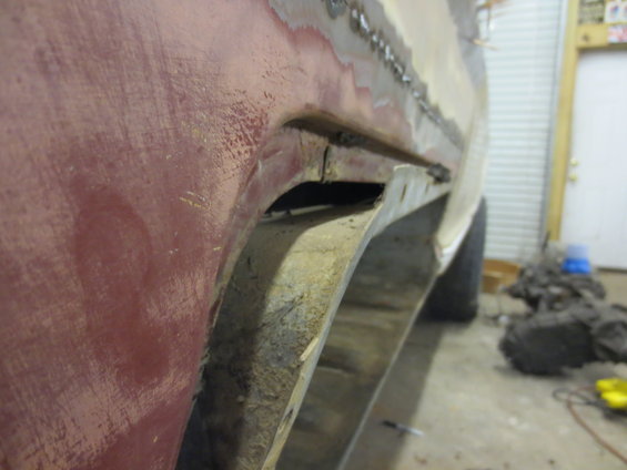

Taking them apart i noticed the factory braces were on all the bedsides even with the toolbox hole. Then cut off for the box installation. After that the box acted as the brace. You Ford factory trivia for today.
The Arizona panel got the nod so started trimming and mocking.
To get a good solid mock i cut it a couple of times to get my marking line right as i want a butt joint.
Little scary.
Very scary but happy with the line...
Some :cuss: several magnets and pliers a patience got somewhere

Hey Manny you still got a hole there! :D
That looks good, not so bad right?? :thup:

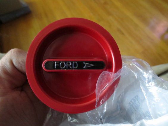

So i've been out and i apologize. Here is my status updates which is not overwhealming but i will try to pick up the pace. First off i got some parts that are back available again thankfully!

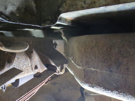

Been still welding grinding the bed side. Had a slight issue with the bed side box though. APPARENTLY there are different liners 2wd to 4wd.. Seems that way as i whacked into the spring hanger. Guess i may copy HFDCO and go to the 2wd hangers or change it around...
Now gotta make my mind up on rear spring stuff don't wanna cut the box.

Nice work Manny, I get where you are coming from about the box cutting but that maybe the easiest way to allow for your spring hanger. It doesn't look like you would loose to much from the box.

cdnwillyg wrote:Nice work Manny, I get where you are coming from about the box cutting but that maybe the easiest way to allow for your spring hanger. It doesn't look like you would loose to much from the box.
I've had my mind on a little bit of altitude adjustment like 2 inches or so. Also not a fan of that big old lift block so this hanger deal may be an excuse to get my lift help eliminate the block. Trust me if suspension was done we would be cutting the box and fitting it. As i am still so green on the project and not fully sorted yet that's why i'm thinking of the hangers suspension mod stuff. I'll get this figured out one day.. :lol:
