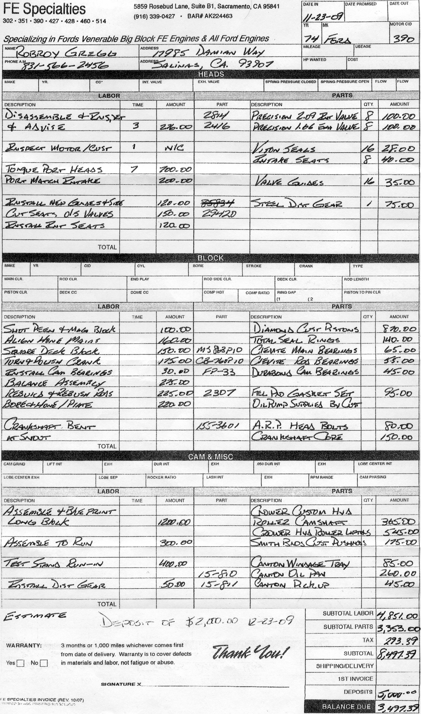

Today I received an estimate from Tom Lucas! Here it is. You can click on this image to see a larger resolution edition.
I haven't completely looked through it myself! But I figured I'd post it here right away for your fine, detailed evaluation.
The only thing that really stands out to me is the "Crankshaft Core" line. I'll have to ask Tom about this on Monday. Last I heard, the existing crankshaft was in usable condition, but this may have been re-evaluated since then. And if so, I'm naturally curious about using a 428 crankshaft instead of another 390! Maybe that's already his plan, but I'll check with him.
Thank you all for the fantastic guidance!

Robroy, that's certainly a detailed quote.
robroy wrote: The only thing that really stands out to me is the "Crankshaft Core" line. I'll have to ask Tom about this on Monday. Last I heard, the existing crankshaft was in usable condition, but this may have been re-evaluated since then. And if so, I'm naturally curious about using a 428 crankshaft instead of another 390! Maybe that's already his plan, but I'll check with him.
If you'll notice, on the left side of the estimate, Tom states, "Crankshaft bent at snout", so that's where the "Crankshaft Core" comes in, as he'll have to replace yours.
I also noticed that he is planning to replace the oil pan.
With that in mind, that's two additional items that you were contemplating crediting to P-U's (man, I love that!! :D) original build as reusable.
I guess it's probably wise to get the engine in the truck and running before approaching them about a refund, as there may be other items that come up.

70_F100 wrote:Robroy, that's certainly a detailed quote.
Excellent! Yeah it looks pretty good to me.
70_F100 wrote:If you'll notice, on the left side of the estimate, Tom states, "Crankshaft bent at snout", so that's where the "Crankshaft Core" comes in, as he'll have to replace yours.
Ah! Thanks for pointing that out. I'll be sure to ask him about a 428 crankshaft on Monday then!
70_F100 wrote:I also noticed that he is planning to replace the oil pan.
Yes! We had a talk about this. According to Tom, when the high volume oil pump is used, the pump actually has the ability to suck a stock oil pan dry. At least I heard that that's true for four quart oil pans. The Milodon 30740's a five quart pan, so I'll have to ask him about this again.
So the only way to guard against that was to either use a stock oil pump (not an attractive option, since I already bought a brand new high volume pump), or put on a different pan.
After speaking with Tom I looked back through some old threads to re-trace my reason for going with the Milodon 30740. And I realized that almost immediately after choosing it, I discovered the Canton "T" pans that included 4x2 FE Bumpsides in their application list. But by then it was too late! Or more accurately, I didn't see a strong enough reason to go with the Canton pan over the Milodon 30740.
So by going with the Canton "T" pan, I'll certainly avoid the potential problem all together. If I remember correctly the pan Tom picked out is a 7 quart pan that looks similar to this:
Since there's nothing wrong with my Milodon 30740 (with its custom drain plug), I'll probably wind up selling it (after confirming that the new Canton pan works without issues).
70_F100 wrote:With that in mind, that's two additional items that you were contemplating crediting to P-U's (man, I love that!! :D) original build as reusable.
True!
70_F100 wrote:I guess it's probably wise to get the engine in the truck and running before approaching them about a refund, as there may be other items that come up.
That's probably a smart idea! Yet I need to balance a measure of prudence with my urge to "get it over with." I'm sure you can understand!

Agreed! Just today I got a voice mail and e-mail from Tom, and have some new updates! Here they are:
  • The old crankshaft was indeed bent on one of its ends. The machinist discovered that when he went to turn it! Because of the bent portion, there would be no way to properly balance the crankshaft after turning it. And since it definitely needed to be turned, it was declared a paper weight. And at 60 pounds, it's a good one.
  • Because the custom pistons were already ordered from Diamond, we'll have to stick with a 390 crankshaft. There's no way to undo the order with Diamond at this point, and I understand that the 428 crankshaft's throw would require different pistons.
  • Tom will add an ARP accessory bolt kit to the engine design for an additional $130. That's for the stainless steel ARP bolts (which he recommends, if I'm going with ARP accessory bolts at all).
  • The estimate I received did not include the cost of painting the engine. He'll price that out in the coming days and revise the estimate.
  • Tom is still trying to get explicit confirmation from Canton that their "T" pan will truly fit my truck. Much to his surprise, so far they've been unwilling to make that promise over the phone, despite their web site making the claim.
  • My exact camshaft specs are (I'm quoting from Tom's e-mail): .320 lobe lift for .563 gross lift on a 110 degree lobe sep. 212 degree .050 intake 228 degree .050 exhaust.
I'm not really let down about the 428 crankshaft. I completely understand the how the situation developed, and am so tremendously grateful for Tom's excellent design, implementation, and customer service skills that I'll happily forget the 428 crankshaft idea!
