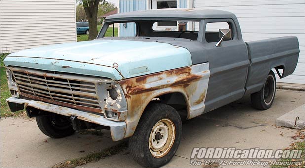

No, not yet. Since I got it I did spend a day tinkering with the vent windows. The previous owner had the vent window frames roughed in, but they need work. In fact, I'm almost thinking that it would be easier to start over modifying a spare set of frames that I have rather than trying to fix the ones that were started.
The cab doesn't need any sandblasting, that's just surface rust you see on it, it'll sand right off. The cab and box are actually very close to being paintable, and I'm thinking about taking a break on the '67 for a while and doing some work on the choptop. I can practice my painting skills with it first.

Anyway, I took some measurements of my choptop truck and compared it to my '67 and found it's been chopped exactly 7". The front window now measures 11-5/8" between the upper and lower channels. The side window openings are 9-1/2" tall and the rear window is down to 5-3/4".

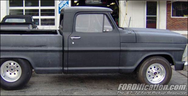

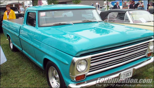

Just for the visual, here's a few comparison pictures showing what trucks will look like with various degrees of chops. Coincidentally, all three are '68s:
3" CHOP
5" CHOP
7" CHOP
The first two pictures were saved from E-bay listings, and I'm simply reporting the total chop as reported in those listings. The third picture is of mine.
