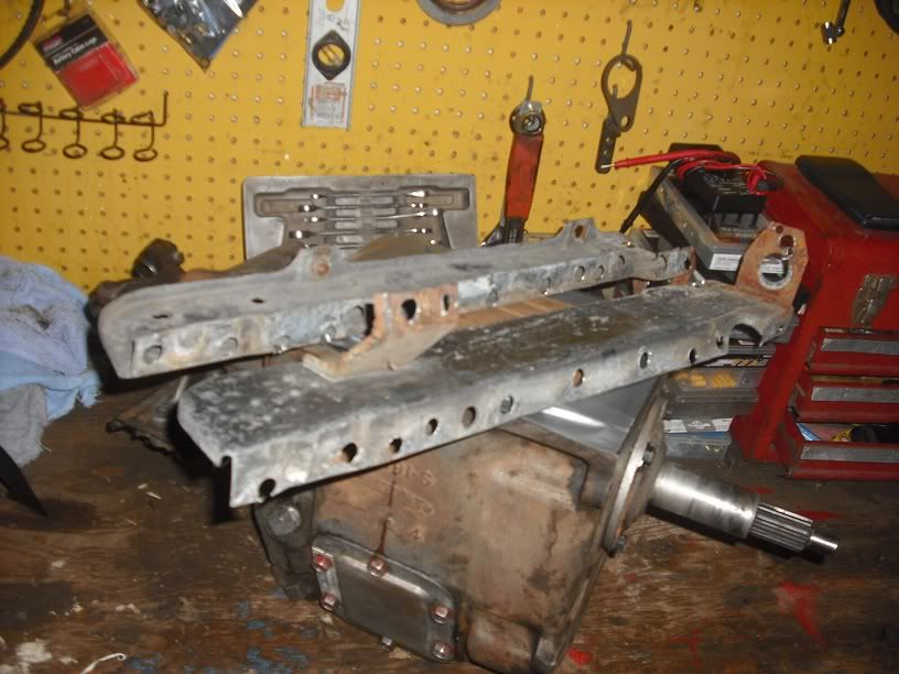

I used my restored 2wd core support on my highboy when i built the truck, and am currently using the 2wd radiator still, but not for long. Picking up my buddies spare highboy radiator and installing it in the highboy on the 2wd core support next week.
I Drilled out all the spot welds on the 4x4 core support brackets before i scrapped that rusted core support.
-Ryan

- Posts: 22330
Re: 2wd to 4wd radiator support question
wow i dont remember that many spot welds on mine. but i bet they were there.
- 1971ford
- Posts: 5565
- Joined: Wed Jul 04, 2007 1:05 pm
- Location: Placerville CA
yeah, that was NOT fun. Can't wait to simply weld them onto the 2wd core support soon. I'll take pics..
