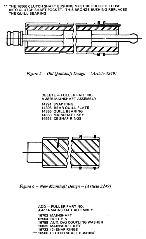

Article 3249 - New Solid Mainshaft - Fuller RT-910-915 Transmissions
TSB #157 - January 22, 1971
(All Extra Heavy Trucks with Fuller RT 910 or RT 915 Series Transmissions - 1971 Models)
The transmission supplier has revised the design of mainshaft on RT 910-915 Series Transmissions from a quill design to a solid shaft, see Figure 5 . This change became effective in transmissions numbered below and service procedures remain the same, except as shown on Figure 6.
PARTS:
ModelSerial NumberFord Number
RT-910S-150441DOHA-7003-AM
RTO-910S-084525DOHA-7003-AN
RTF-910S-158568DOHA-7003-AR
RTOF-910S-085194DOHA-7003-AS
RT-915S-155163DOHA-7003-AT
RT0-915S-087971DOHA-7003-AU
RTO-9513S-160180DOHA-7003-AG
RT0F-9513S-163000DOHA-7003-AH
