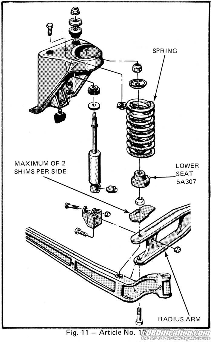

Cab to pickup box tilt or lean attitude can be adjusted by installing one or two shims as required under the front coil spring lower seat 5A307. Refer to Fig. 11. This shim is positioned over the radius arm bolt and locknut with the narrow "tang" rearward.
NOTE: No more than two (2) shims may be installed per side.
