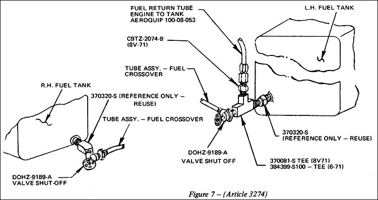

An improved configuration, as shown on Figure 7, permits the shut off of the fuel level line without shutting off the return fuel line as originally released. The new configuration has the added advantage of improving the fuel level flow between tanks.

Part NumberPart NameReq'd.ApplicationClassAvail.
D0HZ-9189-AValve-Shut Off2BothCOK
*C9TZ-2074-B45' Connector18V71COK
370081-STee - 3 Way18V71SOK
384399-S100Tee - 1-1/2"1671NSOK
*Required for Aeroquip Hose
